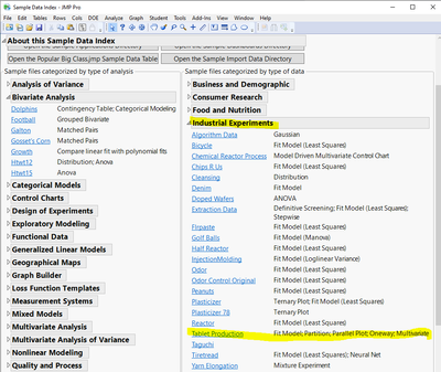

Try this yourself using any JMP table or the Table Production data table Clovis used, and which is part of the JMP Sample Data library.  Thank you Clovis @cweisbart.

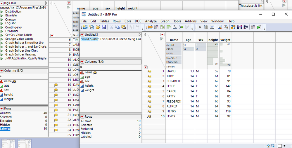

One more nice thing with row selection (and with other options also!) is using Data View. You can create Data View (linked subset) by right clicking on different options on Rows section in bottom left corner of data table. This lets you quickly create Linked Subsets for Selected, Excluded, Hidden and Labeled Rows
jthi_1-1654335457383.pngCouple of links related to data view:
The Data View
Rows Panel in Data Tables (help, jmp.com)
