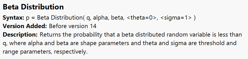

Let us return to the Beta Distribution and consider now if we want to test varying the inputs of the Beta Distribution, focusing on q, alpha, and beta.
