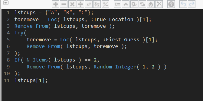

Some of the columns have more complex formulas. For example, the Remove Which Choice column formula is more like a script, including multiple steps to arrive at an output.

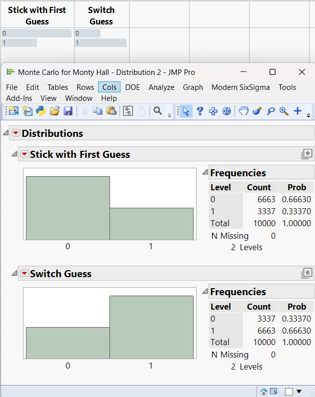

Now that we had a model that could predict the outcome of a few experiments, we wanted to run lots of experiments to predict the general outcome. This is often called the Monte Carlo method. To simulate the outcome of many different experiments, we just needed to add many rows to our data table. Changing the table to have 10,000 rows, we quickly saw in the Header Graphs that switching is the better strategy. We confirmed this with the Distribution platform.

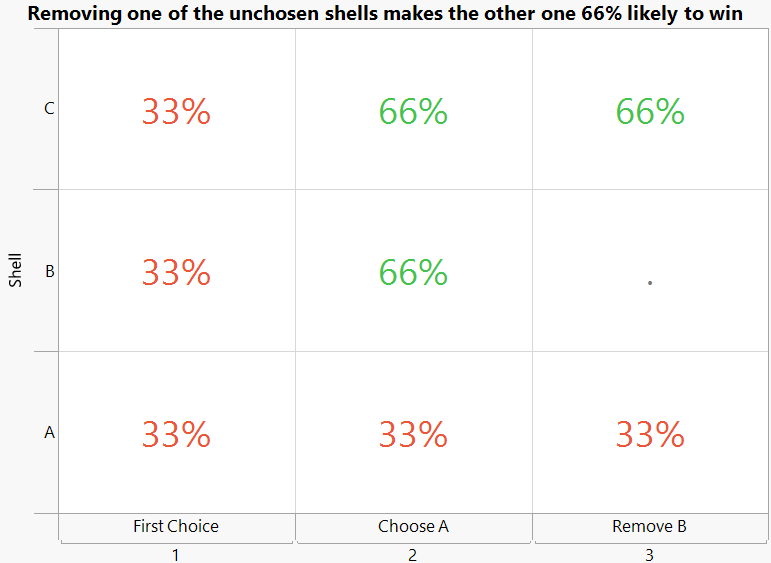

However, the 66% success rate for the switching strategy surprised me. My intuition led me to think that switching would be a 50% success rate versus 33% success rate for sticking with the first choice. As is often the case, visualizing the problem using Graph Builder helped me understand it better. The initial choice has a 33% chance of being correct, while the remaining two shells have a combined chance of 66%. Removing one of the remaining shells doesn't change that 66% chance, but it does restrict that 66% chance to just one shell.
