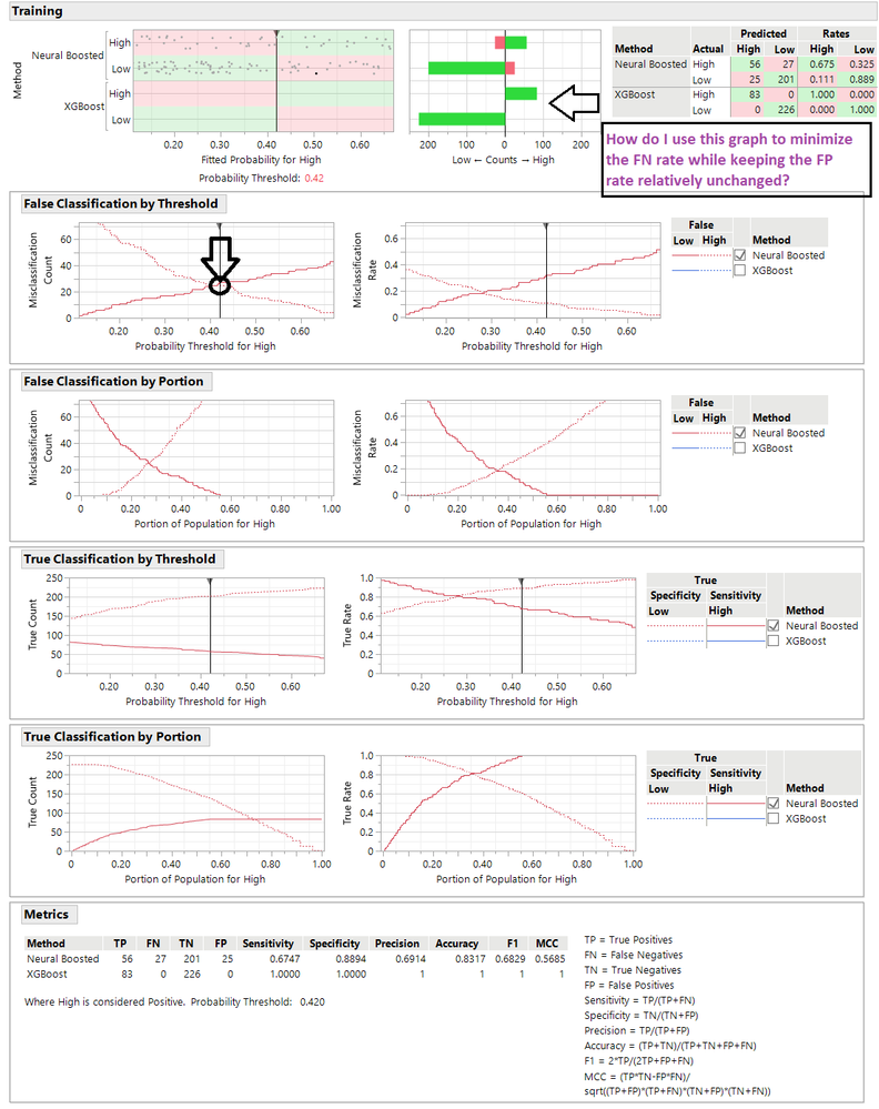

@mia_stephens this is super cool, I'm intrigued by the "Decision Thresholds" feature and am trying to understand it a bit better.  In your example here, did you essentially pick the "intersection" on the Misclassification Count vs Prob Threshold for High Curves (the point i circled in black in the attach image) in making the determination that the Probability Threshold of 0.42 would be a good choice for minimizing false negatives (while maintaining the false positive rate at about the same level?)
I used JMP 16 EA8 and ran almost the same setup except that I specified 'XGBoost' as a model fitting option in the model screening dialogue, (kept the same random seed at 1111).  Untitled-2.png

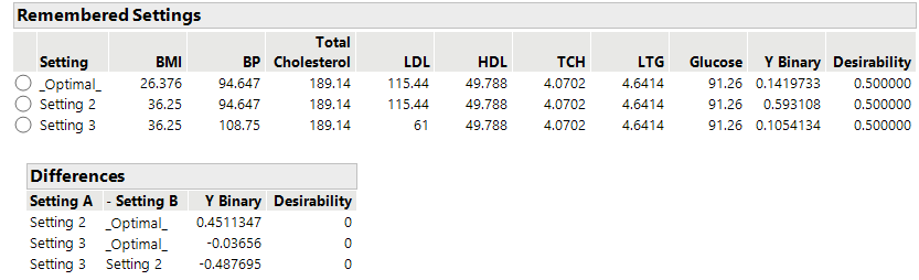

Maybe one useful feature here would be to "remember settings" in a similar way as this can be done in the Prediction Profiler (where it generates a radio button for reach saved setting) so you can easily toggle between different Probability Thresholds to directly see/compare the effect at the specific Thresholds you are interested in. Example image attached.

HI @PatrickGiuliano, this was a relatively superficial example, and I settled on 0.42 as a threshold for illustration purposes. The goal here was to find a cutoff that led to a low false negative rate while maintaining a low false positive rate. But, what constitutes acceptable rates? This depends largely on the research situation or problem, and the "costs" of a particular type of error. For a particular situation, you might be willing to accept a higher false positive rate if it results in a better false negative rate.  The graphs can help to find the sweet spot, to balance the two rates.
This is a small data set, so the results are fairly granular. But, in the second graph here, I see that the false positive rate for neural boosted starts to grow quickly after around 0.45 or 0.5, and the false negative rate drops quickly until around that point, and starts to level out somewhat.
The idea of adding a "remembered settings" option is compelling. Would you be willing to post this to the JMP Wish List?

Hi @mia_stephens   Thanks for your additional clarification! I agree that this is a tradeoff problem that largely depends on subject matter expertise and product/user application and risk.  I see how the graphs are getting at this tradeoff, although  the lines in the trajectory crisscrossing in both directions can be a bit confusing at first I think (the solid lines in the increasing direction, the dashed lines in the decreasing).  I'll add the topic idea to the wish list! @PatrickGiuliano
