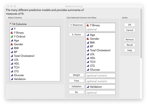

I select Model Screening from the Analyze > Predictive Modeling menu and specify the response and factors. The Validation column partitions the data into Training and Validation sets, so I’ll use this for model validation.
The top portion of the Model Screening dialog is shown here:

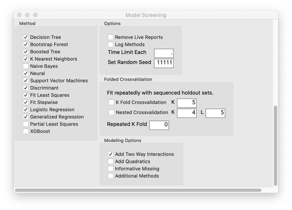

At the bottom of the dialog, there are several different modeling methods to choose from, along with many different fitting and cross-validation options. Note that XGBoost is an available method, because I installed the XGBoost Add-In from the JMP User Community.
I’ll use the default models, but will add two-way interactions and will set the random seed to 11111 to make my results reproducible.

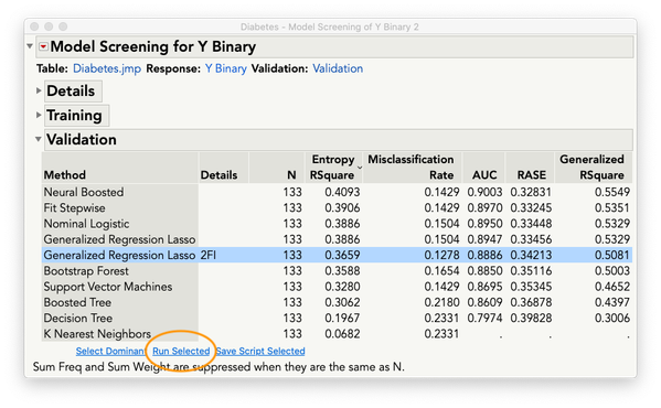

All of the models that make sense for these data are fit, and several validation statistics are provided. The models are sorted in descending order of Generalized RSquare, but to find the model or models that stand out across all of the validation statistics, I’ll click Select Dominant.
I can see that the top models, overall, are Neural Boosted and Generalized Regression Lasso with two-way interactions.

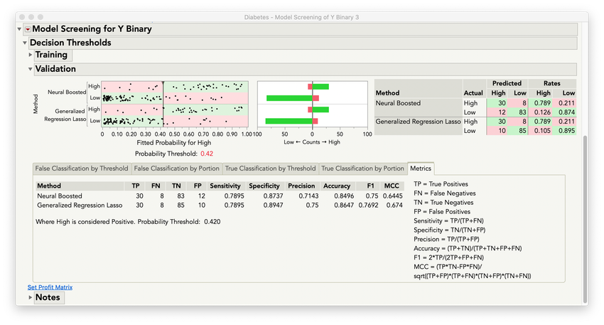

To explore the classifications for these models, I’ll select Decision Threshold from the top red triangle menu. This option provides a wealth of information for comparing the classification accuracy of the selected models. The top section shows the breakdown of true and false classifications for each model, and if I change the probability threshold (either by dragging the slider line or using the edit box), I can see how the classifications and classification errors change for different cutoffs.
(view in My Videos)
The bottom section has tabs showing different classification graphs and metrics. The Metrics tab for the validation data is shown here. In this scenario, I want to identify patients who are most likely to have a high rate of diabetes progression. So, I want to find the model that results in the lowest false negative rate. At a probability threshold of 0.42, the Generalized Regression model has a low false negative rate, while still maintaining a low false positive rate relative to the other model.

Now, I might want to take a closer look at this model. Model Screening makes this seamless. I can easily run the selected model in a new window by clicking Run Selected.
Run Selected.pngOr, without leaving Model Screening, I can see the results directly in the Details outline as shown here. In Model Screening I have access to all of the options I'd see in Generalized Regression. So, for example, I can interact with the solution path, and I can save or publish the model for deployment. I can even run other models to see if I can get further improvement in model accuracy.
