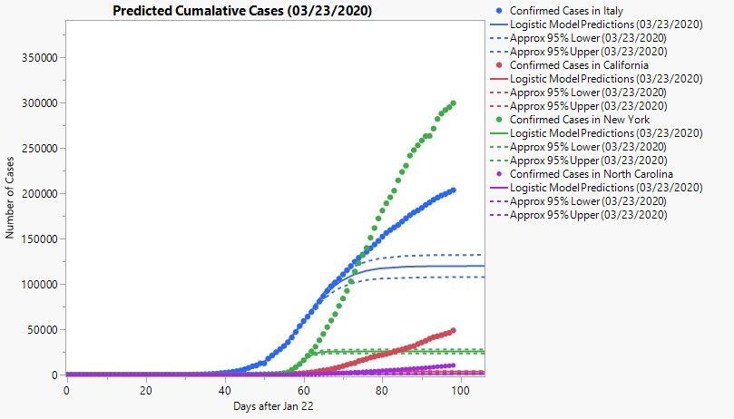

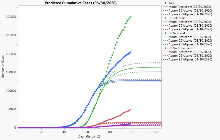

Whelp, I’m still at home and still trying my hand at this whole statistical modeling thing. When last you left me (thanks for coming back!), I seemed strangely optimistic and resilient to the fact that my predictive models had been performing so poorly. Since then, my initial models have continued to tank. In fact, here is a plot of all four along with the current counts up to the writing of this blog post (April 30, 2020).
Yeeaaah, it’s not pretty. Maybe as abstract art, but not as sound predictive models that’s for sure. But, much like heroes of page and screen, adversity has caused me to adapt, and even learn new things!

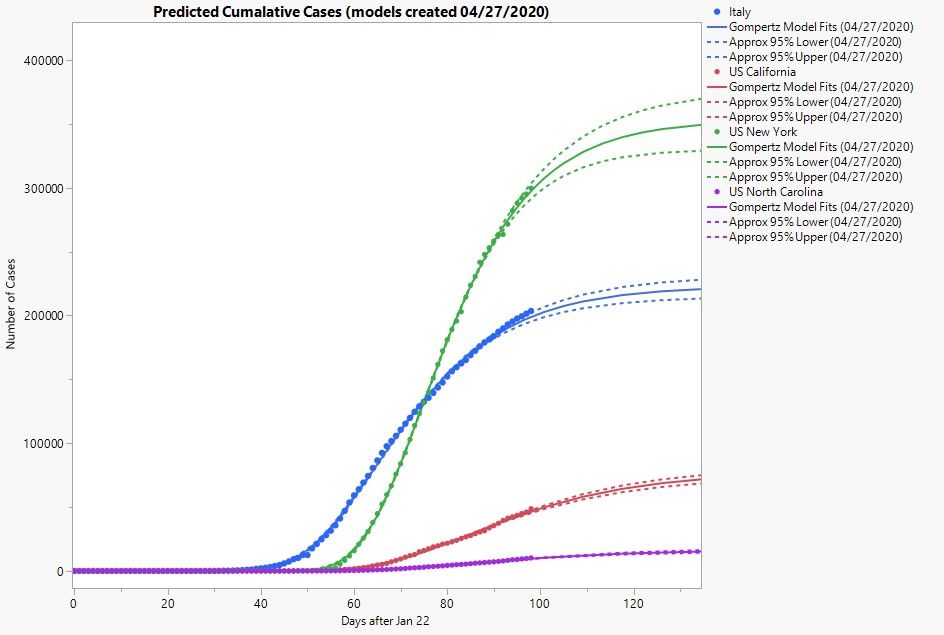

Well, so long as we are under stay-at-home orders, I’ll be continuing my statistical modeling adventures. If you’re wondering how well my new models have been performing, here’s a quick look as of April 29, 2020.

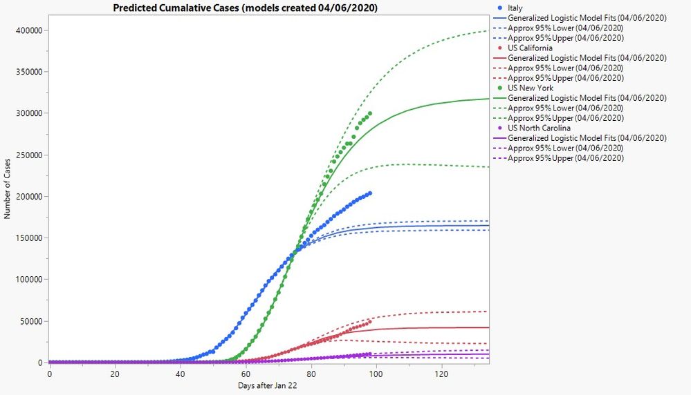

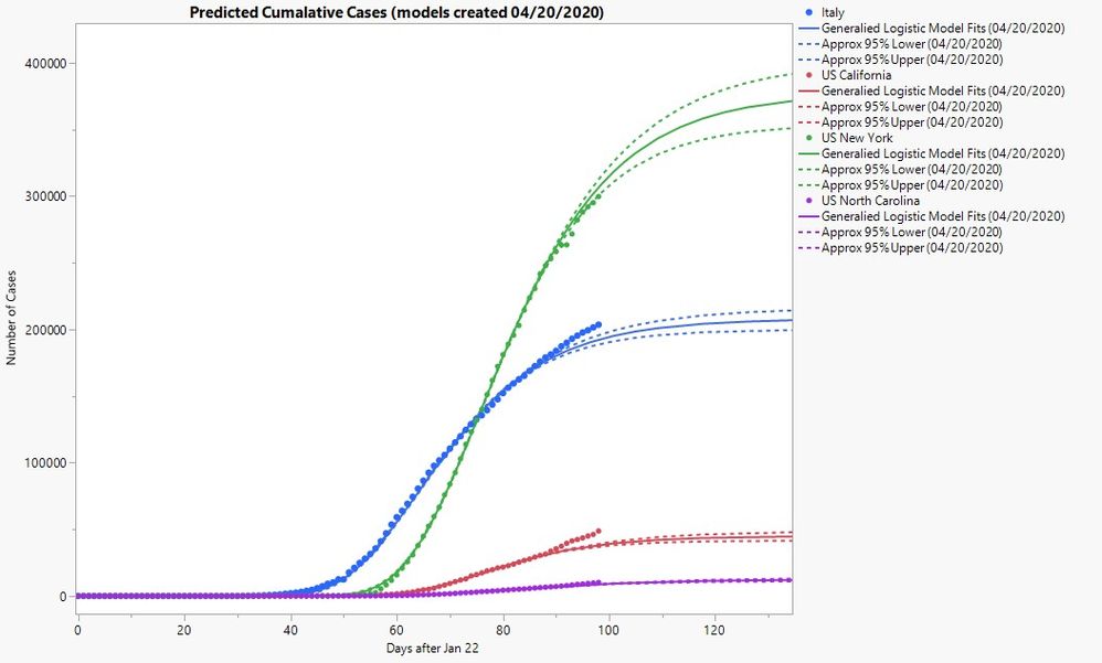

Looks like I’m doing much better! Though having an additional month’s worth of data certainly helps. For the sake of openness, here’s all of the models I’ve been using over the past month shown with all of the data up to April 29, 2020.
You can clearly see a lot of back and forth in how well my models captured future observations. At one point, I did use a mixture of Gompertz and logistic models before ultimately switching to the generalized logistic models, fitting them with the Nonlinear platform in JMP. It was only recently that I noted the parameter estimates were all leaning toward a Gompertz model, which is I why I ultimately switched back to that particular model.
