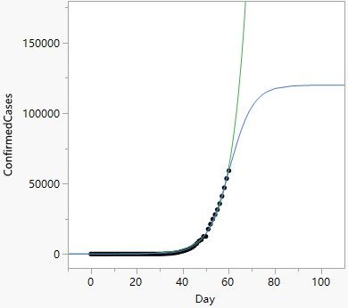

Allow me to illustrate with some real data. Below is a figure showing exponential (in green, assuming this is the model people are talking about) and logistic (in blue) fits to the confirmed counts of Italy (as of March 22, 2020).
Notice that both models fit the data very well. However, the exponential model continues increasing without bound while the logistic model eventually levels off at some higher value. The simplest models epidemiologists use to describe the behavior of illnesses spreading throughout a population is the SIR model. The name comes from how the population is divided: Susceptible to the disease, Infected with the disease, and Removed from the disease. The basic idea is that there is some fixed population of individuals who are susceptible to some new disease and a good portion of these individuals will transition through the phases of Infected and Removed (either through recovery or…). If you implement such a model and keep track of the cumulative counts of infected individuals, you will end up with something that looks a lot like that logistic curve. This is all because of one key fact: There is a fixed population size. Note that the exponential model continues up, up and away like a superhero, oblivious to any so-called population threshold that might seek to oppose it. This clearly does not match reality, where the cumulative number of infected will have to level out at some point either because methods were taken to stop the infections or the entire population was infected.

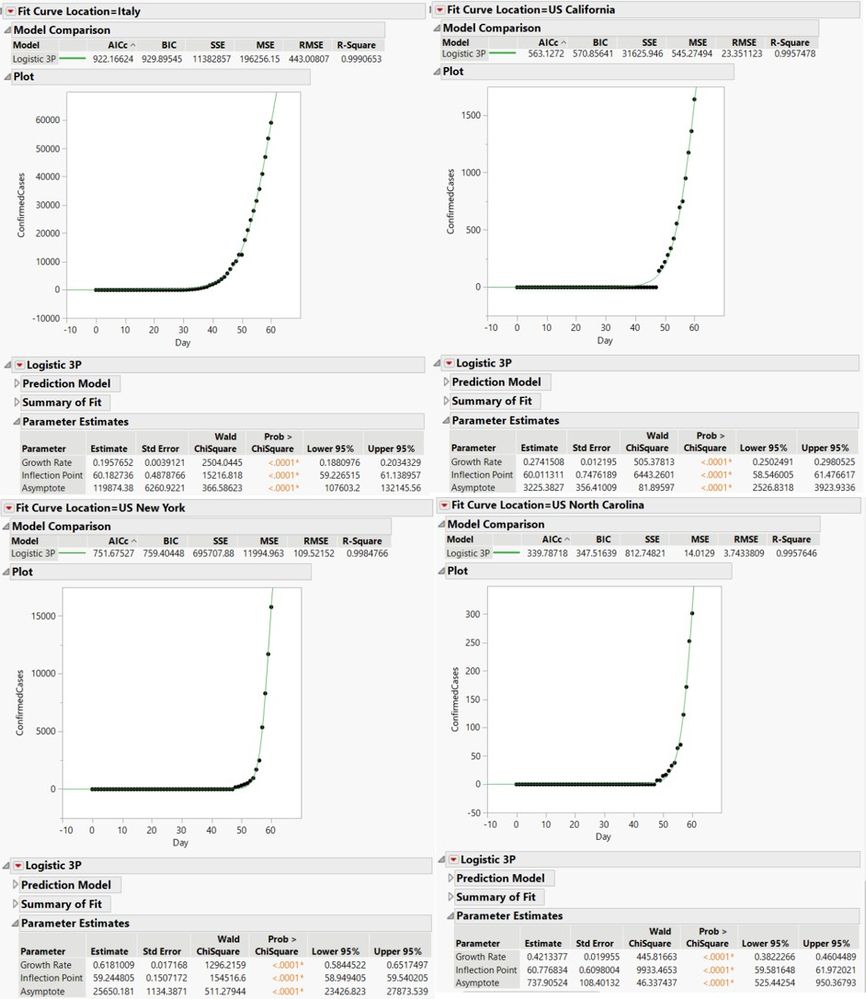

Below are the fits I got using the daily cumulative counts up to March 22, 2020, roughly two months worth of data:
Look at how amazing those fits are! I can just hear the report saying “What’s this?! Such clean data all lined up and so well-behaved. And that near-perfect trend?!! Oh what a glorious day! You sir are to be commended for such exquisite data! Bravo, good sir, bravo!” I bet many data analysts would see this and seethe with jealousy over how near-perfect these fits are. And who’s to blame them? Just look at how clean the data looks! I'd be surprised if I didn't get such great fits! With such low p-values coupled with R^2 values oh so close to 1, these models should be spot on, right? Well…
As you can probably guess from my overtly sarcastic tone, these models are not the gems the metrics purport them to be. Our first warning sign that something may be amiss is to look at the parameter estimates themselves. Note the estimates of the inflection point (recall I said it was the most important parameter) for each location. They are all roughly the same…and they are all the very last day of recorded data. Yep, the model says that you just happened to have caught the very moment at which the rate of cases will start to slow down and cases should start decreasing very soon! How fortunate! Apologies for the sarcastic tone again, but it should be obvious that this is a fluke of the model estimation procedure. In fact, I didn’t even notice it until I was writing this blog. It’s that easy to miss.
But let’s pretend that you were just like me that day and missed that important fact. Having estimated the model, I then realized that I would have a chance to test it out by keeping track of the model predictions vs. actual counts over the next few days. So, that’s precisely what I did.

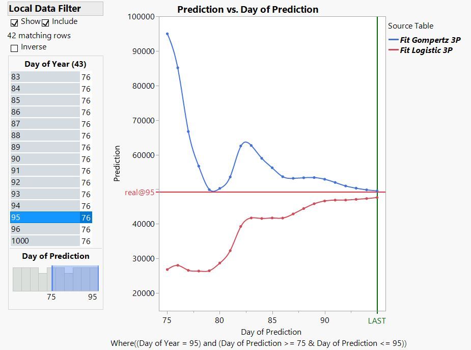

I compared Logistic 3P with Gompertz 3P ability to predict future data based on data collected up to a certain date.  The chart below represents results for Lombardy, which is the most severely afflicted region in Italy.  The curves represent the prediction for day of year 95 (Apr 5th) with data available at a certain day of year (x-axis).  On april 5th  the real number of total cases for Lombardy was 49118.
 Gompertz  3P model (which by the way has the lowest AICc consistently) had been overestimating this value since many days, and converged toward the real value in the very last few days.  Logistic 3P on the other side is always underestimating the real value.  The main lessons I get from this is that long term predictions (beyond very few days) can become very inaccurate and that min AICc is to be used very carefully for this kind of model selection.  I'm not sure how one could apply cross validation as well.

I'm glad to see you playing with different models. It's actually something I'll be discussing in my follow-up post. I was actually using the very same ones you were so it makes me feel like I'm on the right track. As a matter of fact, it turns out the Logistic and Gompertz models are both special cases of a more generalized logistic model, which I've also started using. It has an extra parameter that effects where the greatest rate of increase occurs. I plan on talking about it in my follow-up post as well, but I'm interested to see how it works with your data.
I had thought about cross validation, but I'm not sure how well it would do here in its most common form. The closest you could do would be to subset a portion of the most recent data and use that for validation. Much like @russ_wolfinger did in his Friday JMP On Air presentation, where he used the last week of data for validation.
