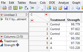

We create three samples with Treatment A and measure the strength of each. We also collect three standard (or Control) samples and measure the strength of each. Here is the data:

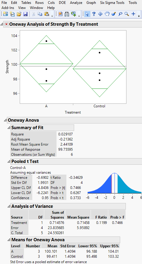

Using the Fit Y by X platform in JMP (see below), we find that the average strength from the Treatment A sample is slightly higher than the Control. However, the t-test says that we cannot say (at 95% confidence) that the population mean of Treatment A will be any different than the population mean of the Control. We stop the test and start looking for another way to improve product strength.
This seems like a simple test with simple-to-interpret results, but I contend that mistakes are being made in the above scenario, and that we might be throwing away a perfectly good solution.
