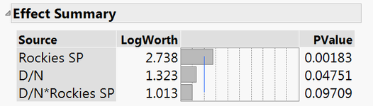

After running the model, I find some of the effects have a high p-value and thus remove them from my model. The three effects that end up being significant to the model are the starting pitcher, day or night game, and the interaction between those two factors.

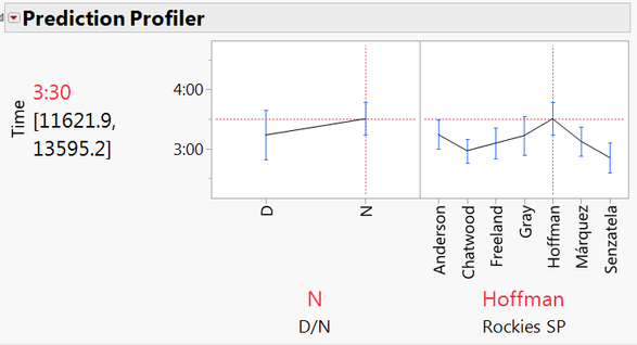

The Profiler in JMP is an excellent way to interpret the model. The Rockies game I am planning on attending has Jeff Hoffman pitching at night.baseball_game_length_profiler.png
I tell my wife I now have a much better estimate of what time it will take for the game tomorrow night. The average night game that Jeff Hoffman pitches lasts 3:30 minutes. So I am 95% confident that the mean will fall between 3 hours and 13 minutes and 41.9 seconds (11621.9 seconds) and 3 hours 46 minutes and 35.2 seconds (13595.2 seconds).
“So, you are 95% confident that the game will last between 3 hours and 14 minutes and 3 hours and 47 minutes?” asks my wife.
“No, if I went to 10 games with Hoffman pitching at night, I am 95% confident the average time of those games would fall in that range,” I respond.
“OK, so how long do you think this game will be?” she asks, shaking her head.
“I can’t say for sure, but the night games Hoffman pitches on average last 20 minutes longer than the average Rockies game.”
“I guess that is useful information,” she concedes.
“As George Box says, 'All models are wrong, but some are useful,'" I tell her.
