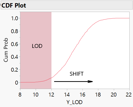

Parameter estimates are typically made with the cumulative distribution function (CDF). With limits present, the result is a shifted CDF and altered parameters. The plot below illustrates the effect of an LOD for a symmetric distribution.
