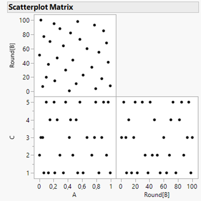

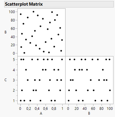

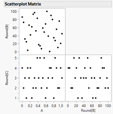

I have a question related to selecting between Latin Hypercube Design and Fast Flexible design for computer simulation.
Consider the factors below;
A: range : 0 -1 (continuous values)
B: range: 1- 100 (All integer values within the range)
C: range: 1-5 (All integer values within the range)
Question: JMP recommends using the FFF design for discrete factors. However, Factor B and Factor C are technically discrete, but there should be all integer points in that range (1, 2, 3, 4,..., 100). I just don't want them to take decimal values for the simulation. Which design should I use?
There is an option in JMP to set the width of the factor values, which allows me to remove the decimal in the Latin hypercube. I'm not sure if that has any implications on the analysis.
Can I treat the factors as continuous in LHD and adjust the width, or use some kind of rounding to get integer values?
The JMP documentation given for Latin hypercube considers continuous input, but the final design table has integer values.

As you may already have read in part1 of these blog series Exploring space filling designs part 1: Introduction to common types of space fi... - JMP User Commu..., Latin hypercube designs creates a number of bins equal to the number of runs wanted in the final design. Depending on how many runs you would like in your final design, this will affect the number of bins for the factors, and how much "rounding up" the values may affect the design. In the example you show from JMP Help, the design includes 8 runs for factors range from 1 to 8, so the Latin Hypercube creates bins of width 1, so that each of the 8 bins is used in the design. When you have factors range that are equal to the number of runs, the bins become discrete integer values.
In your case, you have two very different factor ranges : typically for the factor with a small discrete range (1-5), the number of bins may always be greater than the possible number of values to choose from that range (5). So I would use a discrete numeric factor for this one, as you may end up with a lot of repeated values by rounding up the values in the design, which may affect the coverage and projection property of your design.
Example with Latin Hypercube design with 30 runs and only continuous factors (B and C are rounded up after design generation to have only integer values):
Example with Fast Flexible Filling design with 30 runs, A and B continuous factors (B is rounded up after design generation) and C is discrete numeric :
Example with Fast Flexible Filling design with 30 runs, A continuous, B and C discrete numeric :
It seems that the repartition of runs between the second and third situations are quite similar, and they both use Fast Flexible Filling design because of the presence of at least one discrete numeric factor. The first situation is obtained by forcing a LHD generation with only continuous factors, before rounding them up. This situation doesn't seem optimal, as the distribution of points looks clustered, with gaps in the border of the experimental space.
I would recommend using Fast Flexible Filling design in this case, either with option 2 or 3.
