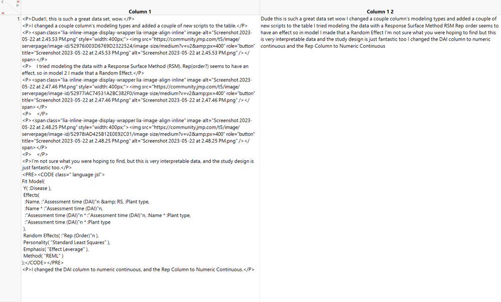

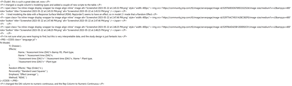

Shown below is an example from just one out of more than 48,000 discussion comments. Note that the HTML formatting and JSL scripting make it very difficult to determine the vocabulary being used in the original comment.
Data sample prior to regular expression cleaning.
Cleaning out these terms and formatting manually could take months or even years to complete, but with the use of just a few regular expressions, cleaning can be done instantaneously.

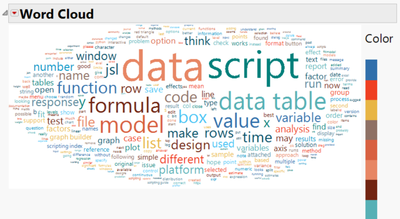

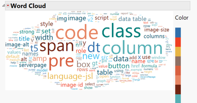

Once we've finished filtering out our custom expressions, how do our results change? Let's look at the side-by-side comparisons of the word clouds for the raw and unfiltered data set vs. the regex cleaned set:
Old (no regex)
New (with regex)
Note that prior to using regular expressions, the data is filled with HTML formatting, JSL formatting, and completely unrelated content. For the purpose of my analysis, this data is completely irrelevant. After employing regex, the data is much more useful for analysis and can provide very interesting results with some more work.

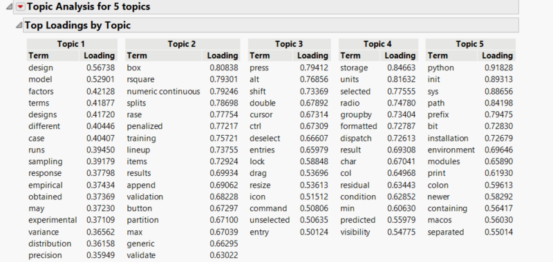

Conducting a topic analysis on the cleaned data provided the following results as to what topics are most commonly answered within the User Community, shown below:
Five-topic analysis on discussions data
The five topics provided can be generalized into different categories of questions that users are asking about:
  • Topic #1: Design of experiment (DOE)
  • Topic #2: Predictive modeling & machine learning
  • Topic #3: Instructional answers
  • Topic #4: Data formatting and analysis
  • Topic #5: Programming and scripting

Selecting "New Column by Text Matching" will open the same regex editor window as the one in Text Explorer. The entire data curation process is the exact same, however, your filtered text will now be automatically formatted into a new column, as shown in the image below:
The same process is shown outside of a Text Explorer window.
