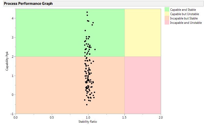

In the Process Performance Graph below, note that your process can fall into four different areas. The green area denotes processes that are both capable (based on spec limits and capability analysis) and stable (based on control limits and control charts). About 1/3 of these processes are both capable and stable. The yellow area denotes processes that are capable, but unstable. None of these processes fall into that category. The orange area denotes processes that are Incapable, but stable. About 2/3 of the processes fall into this category. The final category is red, which indicates incapable and unstable, which none of these processes fall into. In this graph, all of the processes are stable (in control), but only 1/3 of them are capable (meet the specification limits).The Process Performance Graph divides the processes into the four categories of capability and stability.The Process Performance Graph divides the processes into the four categories of capability and stability.
