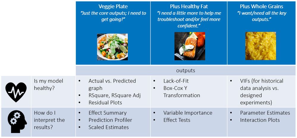

Model health and interpretation menu
Model outputs can be broken into two main categories of outputs: model health and interpretation. Model health outputs help you determine if your model is healthy or if you need to perform some “first aid.” Interpretation outputs are those that help you decide which factors are important and how they influence the response(s).
I have developed the menu in Figure 2 to help you focus on the key outputs based on how deep you want to go (or how hungry you are, so to speak). I think it’s only appropriate to use healthy foods in this menu because we are all on our best behavior (or have the best intentions) when setting our new year’s resolutions! My previous drafts of this blog post used a fast food menu board, which seemed…incongruous :smiling_face_with_smiling_eyes:. I offer you three meals:
Figure 2: Focus in on the key outputs in Standard Least Squares.  Choose your meal based on your appetite!Figure 2: Focus in on the key outputs in Standard Least Squares. Choose your meal based on your appetite!
  • The Veggie Plate has the core outputs only and is for the analyst who is looking to move quickly or whose analysis allows for that simplicity.
The Veggie PlateThe Veggie Plate
  • The Veggie Plate + Healthy Fat (salmon is one of my faves!) includes the Veggie Plate outputs plus additional outputs that can help with finding remedies for poor model health or for analysts who really like getting into the data. Omega-3s have so many healing benefits!
Veggie Plate + Healthy FatVeggie Plate + Healthy Fat
  • Finally, the Full Square Meal includes outputs (“Whole Grains”) that are appropriate when you are struggling to get a good model or when you are just feeling extra hungry for more outputs to help you understand your problem.
The Full Square Meal: Veggie Plate + Healthy Fat + Whole GrainsThe Full Square Meal: Veggie Plate + Healthy Fat + Whole Grains
