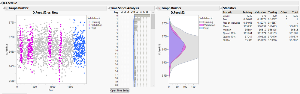

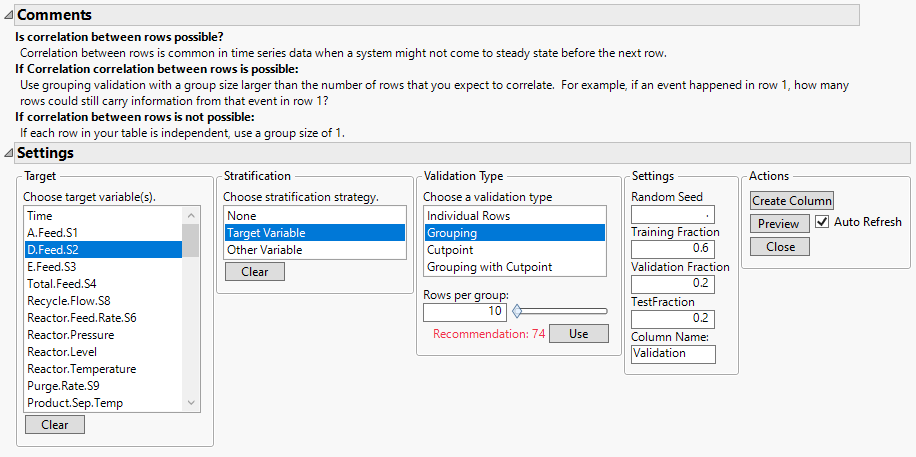

The user selects target variables, if applicable. By default the first of these is used for stratification, although this doesn't always affect the split depending on the group and table size.  The default validation type is Grouping and a recommended group size is presented.
Some information on target variables is displayed to help the user identify an appropriate group size.

The recommended group size is based on a time series analysis of each target variable.  The platform picks a lag time where the next several rows have an autocorrelation smaller than 0.1 and then ensuring a minimum number of groups in small tables, and increasing the group size in large tables.
