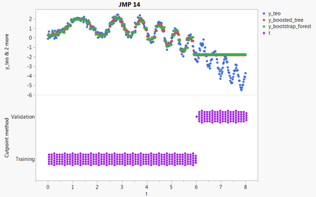

And if the cutpointvalidation method is used as a column to fit trees (recommended for time series in JMP):

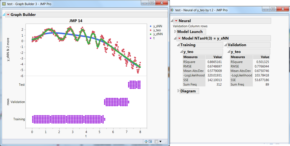

When using Neural Networks and the validation column, the results are a simple extrapolation. Test rows are not used in this interface either.
