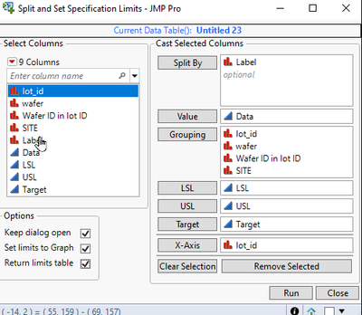

Purpose of this tool is to let JMP users split long (stacked) data and set specification limits directly from the original data if data is in correct format. Tool requires data table in long/stacked format, with some of the following columns:
  • Column for measurement name
  • Column for measurement data
  • Optional grouping columns
  • Column for Lower Limit
  • Column for Upper Limit
  • Column for Target
  • Optional column for X-axis if you want to plot immediately after splitting is completed
Selections:
Limits table:

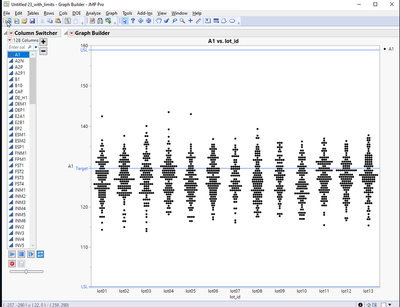

Graph if X-axis column is provided:
