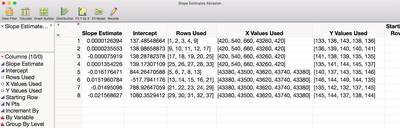

Using the Abrasion.jmp data table from the sample data and the selections noted above will yield the following output.
A new data table is created with the name of the original data table appended to "Slope Estimates" forming the name in this example as "Slope Estimates Abrasion.jmp".
//Get table name
dtfn = dt<< Get Name;
dtn = Word(1, dtfn, ".");
// Create name for new table
tbln = "Slope Estimates " || dtn;
One row for each slope and intercept calculation is added to the new data table.  It will also add which rows were used in the calculation and the starting parameters for "# Pts", "Increment By", "Start at Row" and any variables cast into roles.
Because the table takes advantage of the new data type in JMP 12 called Expression to store the rows matrix it is only compatible with JMP 12 or newer.

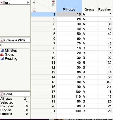

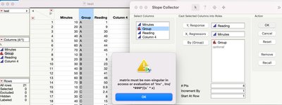

Hi Stan, I am trying to slice my time series data and calculate slope for each slice. Because I have a high dimension data set, I imagine your tool might be extremely handy and I won't have to recreate it. It's just that I am running into issues.
I am getting this error where it says "matrix must be non-singular in access or evaluation of 'Inv', Inc/*###*/(x`*x)
Do you have any hints? Also, is there any way I can get my hands on the script in the background to modify to my specific needs?
