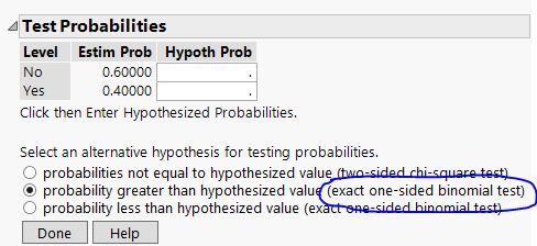

I have a question --what was the alternative hypothesis used? I'm thinking that it should be that the proportion of Correct Answers > 0.3333, because that is evidence that there is truly a difference between products A and B. The triangle test is a discriminatory test, so we care about whether panelist choose the correct answer more than would be expected by chance.
[cid:image001.png@01D2D0B0.86FD89B0]
When I ran the test with the one-sided alternative hypothesis, I got a slightly different probability than was in the Distribution script supplied with the sample data. Not sure if this 2-sided Chi-Square test was intended to represent a triangle test.
[cid:image002.png@01D2D0B0.86FD89B0]
Regards, Paul
Hi, Paul.
The Chi-Squared is always a one-sided test. StatsExchange over on StackOverflow has a nice discussion on this.
So, following the guidelines on SensorySociety.org, the stated p-values are correct.
One could argue that we should perform a two-sided test instead. JMP offers that as an exact binomial test.
That test is not as well-known, and I haven't seen it recommended in the sensory analysis literature. I feel like I'm in a bit of a bind when it comes to reporting p-values for the user. The software is written to spec, but maybe it's not what a statistician would recommend generally.
What's your opinion?
