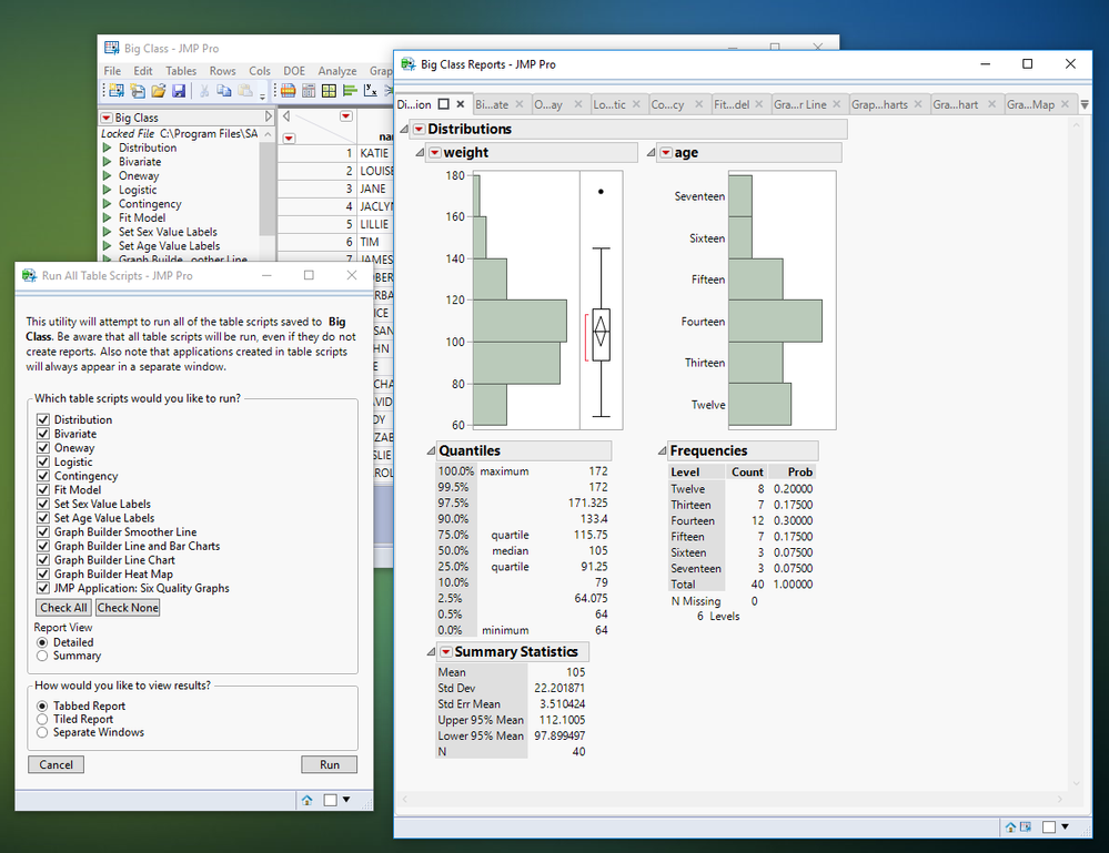

This Add-In allows users to run all of the scripts saved to a data table at once. There are also options to select specific scripts from the table, choose between detailed and summary reports, and specify how you would like to view the results. There are three different reporting styles to choose from: Tabbed, Tiled (two-column), and the classic Multi-Window view. This add-in should allow users to easily create useful reports from data tables they work with frequently.
For more information, read my blog post on this add-in.
