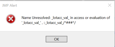

21 July 2021:Version 1.4
  • Bug fixes
  • Fixed issue with error related to ::_lotacc_val_ not found

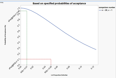

Thanks for creating this!  I ran it and just used the default settings and got this:
Should the blue line be going through the "elbows" of the color lines?
@shampton82
Thanks for pointing this out to me. And yes the reference lines should touch the OC curve.
I'll post an update shortly with some enhancements and bug fixes.

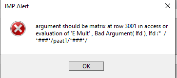

Variables sampling plan does not seem to work on JMP 16:
smoke
@stan_koprowski, can confirm the same error box popped up as @Fideliter .
I went through the menus as follows: add-ins->Jmp Sampling Plans-> Variables -> Sampling by Variables -> Generate/Create Variables Plan -> (leave the stock values in the window and then hit ok). = Same exact error box as above
I am on JMP 15.1.0 as well
Hi @Fideliter,
Sorry for the delayed response.
I will post a fix for the error you noted this evening.
cheers,
Stan
Hi @smoke,
Thank you for confirming the issue noted previously.
I will post a fix later this evening.
cheers,
Stan
@Fideliter and @smoke,
I have updated the add-in to v1.4.
Thank you for trying it out.
Please do let me know if you have ideas for enhancements, new feature requests or encounter other issues.

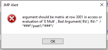

I am getting an error when running the double sampling plan analysis.  Here is the error.
Here is the input information. (level II inspection, letter code H, AQL=1% used from MIL-STD-105E)
n1=n2=32  N=500  AQL=0.01625  RQL=0.1225 (from NIST handbook section 6.2.4) ;  pass 1 Ac=0 Re=2 ; pass 2 Ac=1 Re=2  ;1-alpha=0.95 beta=0.10
Any ideas on what I am doing wrong?

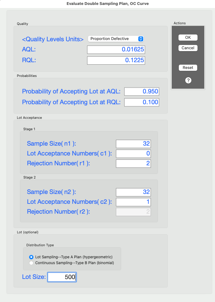

Hi @JimHartwig,
Sorry to learn you encountered an error.
I did a quick test and got the following output.
double sampling plan dialoguedouble sampling plan dialoguedouble sampling plan outputdouble sampling plan output
Please confirm which version of JMP and which OS you are using and I'll take a look at my code and post an update shortly.
cheers,
Stan

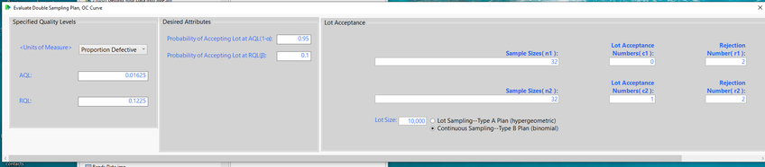

JimHartwig
I have JMP 16.2 using Microsoft version 11.  I have a horizontal input screen, not a vertical one that you show in your response.  I continue to get errors every time I use the add-in.

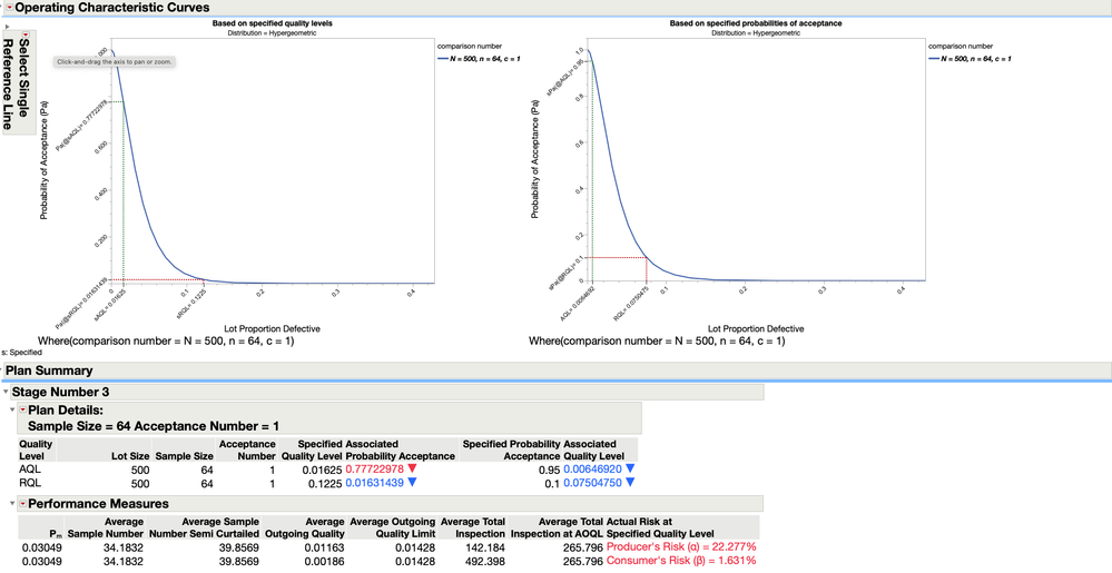

istateres
I think there is a display/rounding/etc. issue with the "Associated Quality Level". The correct values (based on the Binomial) for this sampling plan are: 0.000163 and 0.009465 (rounded to 6 decimal places). So while six decimal places are being displayed by the Add-in, it looks like results rounded to 5 decimal places are actually being presented with a trailing zero.
I'm using version 16.1.0 of JMP and the current Add-in downloaded from the web.
