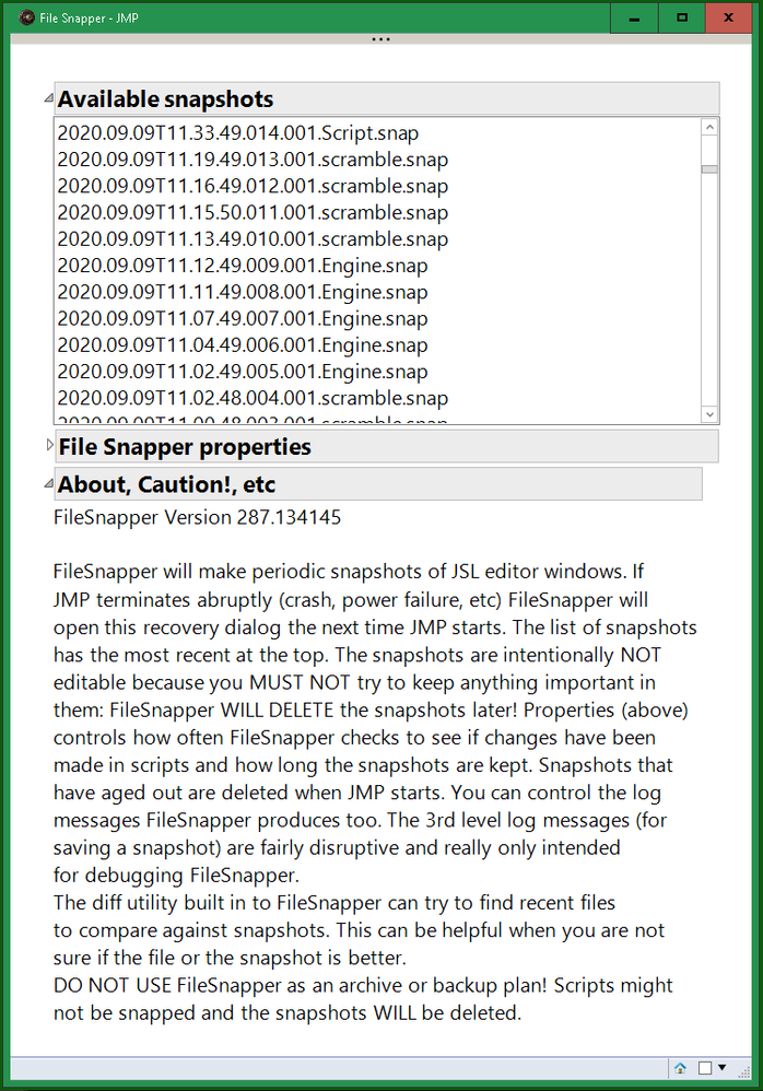

FileSnapper makes periodic snapshots of JSL editor windows. If JMP does not have a chance to save your JSL (crash, power failure, cat on keyboard), the snapshot might help you recover.
The escape key can sometimes stop FileSnapper. Because of the way FileSnapper works, there will not be a warning and the snapshots will not be made. You should still make your own backups, etc. The snapshots are deleted after 14 days by default.
FileSnapper dialog
