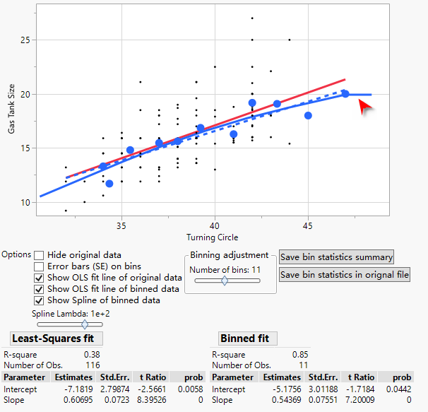

Here is a JMP add-in to do what I have called dynamic bivariate binning. It is useful to explore very noisy data by simply aggregating the X and corresponding Y data into bins of various sizes. The binning can be done uniformly along the X axis or dictated by the density distribution of the X data. It produces in a bivariate plot of bin averages with facultative error bars in both directions and some other options. It also provides dynamically changing least-squares statistics. Once you have chosen the desired level of binning, you can export the bin statistics to a new JMP file. Happy binning. Yves

I have had a try on this addin, it is great, but it cannot fit equation/function of spline and lines. Can it be improve this function?
Hello Mujahida,
First of all, sorry for the delay in responding. I don't quite understand what is happening because the function works well for me. What version of JMP are you using?
Best regards, Yves
mujahida
Hi!  yvesprairie
yes, it can work well, for output report, I can write following function:
y=-7.1819+0.60695x
y=-5.1756+0.54369x
but, What's the spline's function/formula?
Hi mujahida,
In response to your question, the spline function is not a simple mathematical function, it involves a series of coefficients  that change along the X according to certain intervals. It is not practical to export a matrix of coefficients.
Regards, Yves
