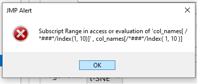

Good evening, dear colleagues!
I have installed R 3.6.3 and RStudio on my Windows 10 (64 bit). Installed both packages successfully and the example file for the add-in worked out well properly visualizing the data. However, as long as I launched my file (32 rows, 7 columns of the predictors, 1 column as "label"), the process resulted in an alert below.
Could you please, explain, what was wrong. All the columns were numerical-continuous like in the example, MNIST.jmp. The only difference was that the numbers in 7 variables were non-integer: like 0.234234 ou 0.472343.
I will highly appreciate your advice.

Hi MJ,
I like your Add-In, but I wonder why you have set the number of input dimensions to at least 10. I have cases where I have fewer dimensions that need projection using umap or tsne.
Thank you.
Best,
TS
Hi MJ,
I found the offending code lines that throw an error when fewer than 10 columns are selected as Variables.
There are two calls to the following function that I simply marked as Comments:
print(col_names[1::10]);
These are not needed for the Add-In to work perfectly well.
Best,
TS
