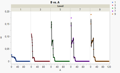

For a multi-level example as shown below

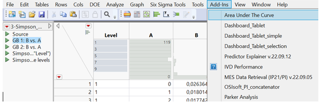

First open the JMP file, then click on the 'Area Under The Curve' add-in.

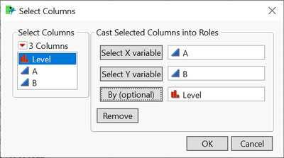

You will be prompted to select the variables 'X' and 'Y' and an optional variable 'By'.

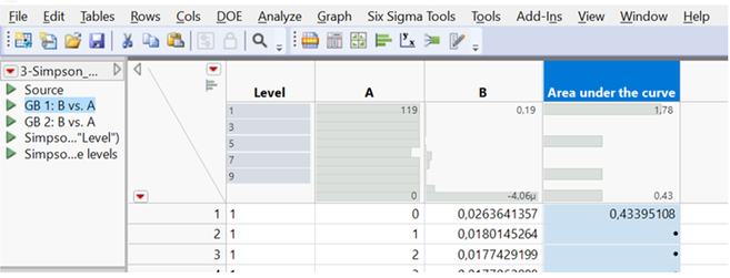

Click "OK" and a new column will be added at the end of the data table containing the area under the curve in the first row.
In the case of multiple levels, the results will be in the first row for each level, as shown in the graph below for "Level 1".

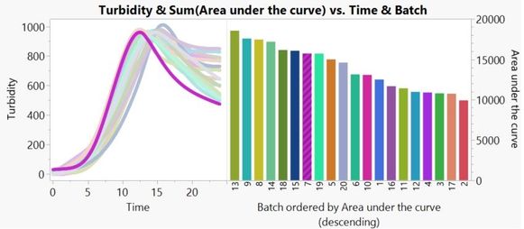

Nice @Emmanuel_Romeu Gets me a step closer to what I would like to do in Graph Builder.  Takes a few steps but possible.
