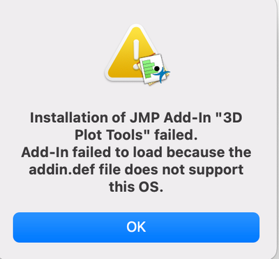

adamjacks
Hi all!
I have used this plug-in before and I love it. However, I noted that in the most recent JMP update, it is not working or giving me an error.  I have pasted below, but in case it doesn't show, it says: "Installation of JMP add-in "3d plot tools failed...because the addin.def file does not support this OS. I am working on macOS monterey version 12.4.
Thanks in advance for any input!
WPeveler
I have the same issue as the poster above - JMP17, MacOS monterey. Any help gratefully recieved as this looks to be a great addin.
ih
@adamjacks   and @WPeveler  I apologize as I missed the much earlier note.  Yes I will take a look and get back to you.

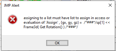

hogi
@ih
When I want to remote control a Scatter Plot with a Local Data Filter, I get the error message:

@adamjacks and @WPeveler :This does not appear to work correctly on a Mac, unfortunately I don't have one to play with, so I'm afraid someone else would need to help solve that problem.
@hogi: thank you for reporting the bug and I like your idea of an option for a smaller range of motion.  I will put both on my to-do list, I can't give a timeline though.  I would be happy to review pull requests over github though if you feel inspired to dig into the coding!
