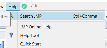

To find "easily" searchable options use either "Search JMP" from JMP's help menu or .pdf documentation (JMP Help web page search is very difficult to utilize in helpful manner), https://www.jmp.com/en_us/support/jmp-documentation.html. For the .pdf documentation you can also install an add-in which adds these to your JMP (these were removed in JMP18, not exactly sure why, maybe they want us to utilize Search JMP).

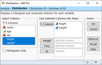

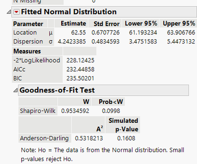

It also helps if you understand how JMP has been designed or meant to be used, you go from visual to more analysis. In this case, you most likely would want to first see the distribution of your data. Then fit some distribution and finally test how well it fits ( Discovering JMP > Introducing JMP > How Do I Get Started with JMP? and Discovering JMP > Introducing JMP > Understand the JMP Workflow ). In this case it happens by launching Distribution platform and then fitting a distribution from the red triangle menu of the column. And after that you run goodness of fit from the fitted distributions red triangle menu (this can then be automated via scripting/workflow or utilizing presets).

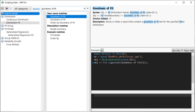

  1. Scripting Index + Help button
    2. Pressing Help will bring me here https://www.jmp.com/support/help/en/18.0/#page/jmp/fit-distributions.shtml?os=win&source=application... and from here I can find jthi_2-1728418122430.png

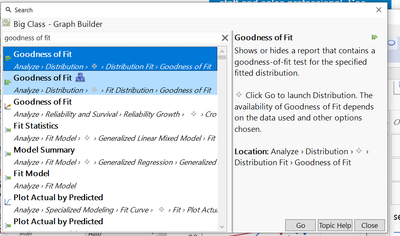

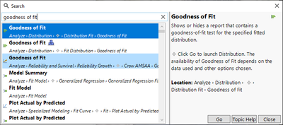

  3. Search JMP from Help Menu

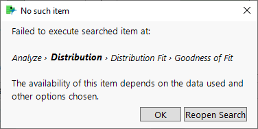

    2. Again you can press Topic Help or optionally try to utilize "Go" on your data
      1. "Go" won't always work as some of the features do have per-requisites (like goodness of fit test) but it can give an idea where to go
      3. jthi_5-1728418284031.png this maybe gives an idea that I have to fit a distribution and then find Goodness of Fit after that (red triangle of fitted distribution)
