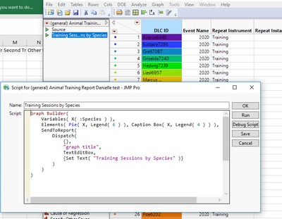

Your example makes sense and it is what I would think would happen. I'll post the script below and some screen shots. Question: Does the source matter - can the two sheets come from different locations or should they all be in the same location(folder)?
I am copying script for "Training session by species" from "Kate" and pasting it to "Danielle":
So it is showing up but when I hit "run" nothing happens (at least this time it did not take me back to "Kate's" sheet)
Thank you for your help!
