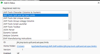

I have found a Split and Set Spec Limits plugin I would like to use in my automation.
When I use the plugin no activity is recorded in the log file (which is likely expected given I am using a plugin). Is it possible to use it in the workflow or the JSL script?

You can find the files used in the add-in from the add-in installation folder
In this case most of the code you most likely need can be found from split_and_set_spec_limits.jsl which is in bin folder.
