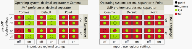

This is how it looks on my Win / JMP18.1.1 system:
(to make it easier to read I put the symbols for comma and point on top of each other)
Some findings:

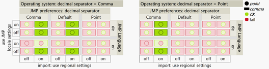

  • There are some combinations where it's simultaneously possible to import txt files
    with comma AND point as decimal separator : )
    No need to adjust the settings.

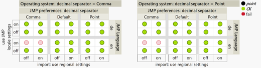

  • For txt files with point as decimal separator - in general it's possible to import them.

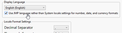

    ... with one exception: hogi_10-1735808632319.png, the combination of
    1)  English, Spanish ... display language (German is fine)
    2) JMP locale settings and
    3) decimal separator: comma

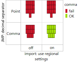

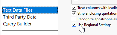

  • If JMP displays data with comma as decimal separator, it's also possible to import such data:
    ... just activate use regional settings in the preferences:
  • An additional rule can be derived from this graph (top half):
    When JMP displays data with point as decimal separator it's not possible to import txt files with comma separator.
