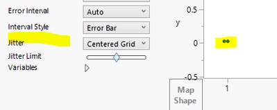

peng_liu
Level VII
Re: two or more x and y graph on one graph
Do you mean that you have duplicated points in your data? E.g. in (x1, y1), you have two points: (0,1) and (0,1). If so, I am wondering whether that is due to jittering.
