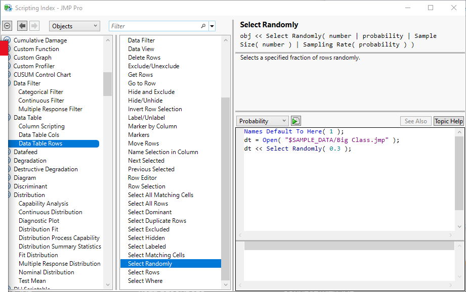

  The following script should help you get started where you want to go. I would not recommend linking the subset to the main table because if you do, when we delete those rows in the main table using the script, it will also delete the rows in the subset table. Anyway, this should get you started in the direction you want to go.
Names default to here (1);
Random_rows = dt<<Select Randomly (0.2);
Random_dt = dt <<Subset(Selected Rows, random rows, selected Columns Only (0), link to original data table (0));
dt <<delete rows;
Hope this helps!,
DS

Thank you Diedrich!  And thank you for suggesting the JSL Script Index for help.  It is working perfectly.

Thanks Mark - Does the excluded row state allow for a random selection of rows (say 20%) to be excluded from the original dataset?  It was not obvious in the JSL script index.
