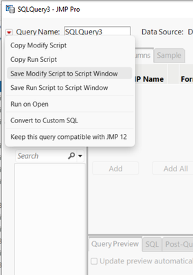

Hi @DualBison1041 , yes there is a way to get the connection string, you can generate a JMP Database Query by:
  1. File => Database => Query Builder (or in JMP 19 File=> Connect to => ODBC => Query Builder
  2. select the connection you want (e.g. ODBC: new connection, computer data source ...)
  3. Next
  4. Build query
  5. then e.g. save modify script to script window will show you the connection string
BR
