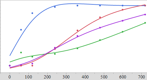

Hi,
I have a set of tablets in which one component determines how slowly the active is released (measured at 1, 2, 3, 4, 5 and 6hours).
If I have the results for tablets containing 10, 15, 20 and 25% of this component how can I create a model that will tell me how much of that component is needed to obtain a target profile (target release values at target timepoints)?
Thanks

I have no problems with fitting the curves. My problem is that each concentration/fit has a different slope/equation and I'd like to have a model that would tell me what concentration of the excipient is needed to obtain a given profile – that is to say I have a target fit of curve and I'd like to know how I can achieve that based on the results of the other fits.

When I have a target profile it means that I have target values for the various timepoints (e.g. timepoint 100: 10%, 200: 15%, 400: 45%, etc.) so not just one point. And I would need a model that would tell me what concnetration of X would give me a closest match.
My best shot so far was to create a single factor DOE where I set the timepoints as the responses and simply overwrote the parameters in the provided table with the parameters and results of my experiments and used the profilers.
But there must be a better way to do that, I guess.
