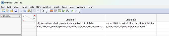

I have a column that has long strings (see example below). I want to extract all the text after the 7th delimiter of "_"  from the right. I tried munger but doesnt seem working well at the end part.
can someone provide suggestion how I can do it right?
1)shjdjsh._ndjrpe_hfkjd_tyrwytre5_hlhm_jgds.d._jkdjf_hfkd_a
desired output: ndjrpe_hfkjd_tyrwytre5_hlhm_jgds.d._jkdjf_hfkd_a
2)hhd_wew_klf:_jdbfjdf_qwkokv_ctls_msdn_a_f_g_skjd_lad_vtl_sdjnskjshdja_jndf_skdj_ccf
desired output: g_skjd_lad_vtl_sdjnskjshdja_jndf_skdj_ccf
