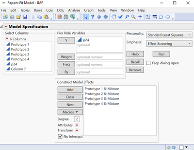

loganshawn
Level III
Re: space filling mixture DoE design for cell culture media
Hi,louv, thank you so much for your effort. I really appreciate it. I am sorry that I have more questions.
1. Based on your attached file, when I clicked DoE dialog, there are some data table with random data. I am wondering if you have generated space filling DoE data table and pasted my data into that data table?
2. I actually did the same way by generating DoE table through Classical>Mixture design> space filling. Then, I just simply copy and paste the date from my excel into the data table. However, the modeling result is different from the modeling result of yours.  From your model, when I maxmize desirability through prediction profiler, it shows that 0.85 X1 and 0.15 X3 will have maximum desirability. However, from my model, when I maxmize desirability through prediction profiler, it shows that 1 of X1 and 0 of X2, X3 and X4  will have maximum desirability.
I am wondering why there are such difference from same data?
BTW, what does "No intercept" mean in the below picture? I found that check or uncheck "No intercept" make big difference of modeling result
Thank you again.

louv
Staff (Retired)
The model which I have scripted includes two-way interactions. The data I entered was based upon your data table along with the column properties to reflect your setting ranges. The R2 for the model is improved with interactions. IMHO the best way to see if your model is useful is to try to verify via experiment.
