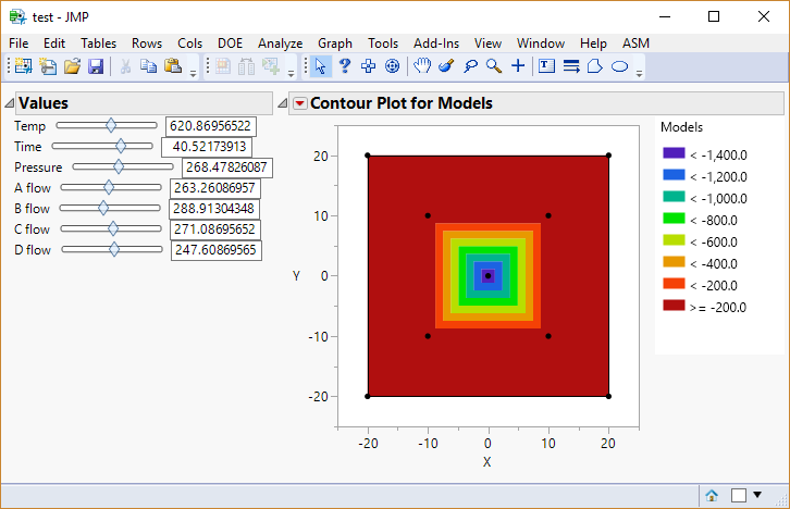

sliders update a table that updates a graph
I'm trying to use sliders to update a table, then the models in the model columns update to predict new values (on a wafer map) which then redraws the contourplot. The problem is that when you turn automatic recalc on and append the sliders to the contourplot, the sliders get thrown out on recalc.
I can keep the sliders and the contourplot in seperate windows but then I have a problem if I work in a JMP project and I have to get into scripting the tab report layout.
I do not need to stay within a table - graph with sliders format, we could also do all of it in memory but I don't think that rebuilding the contourplot in code is fun. Graph builder is also fine as long as I can draw point maps.
The current solution in this new window() works but when moving the sliders I'm deleting and reattaching the updated contour plot which is a bit of a hack job and slow. So i'm looking for a better solution!
Example table attached.
Example script attached and here:

sjaakie = New window("test", testlist = h list box());
CP = GraphingTable << Contour Plot(
	X( :X, :Y ),
	Y( :Models ),
	Show Data Points( 1 ),
	Fill Areas( 1 ),
	Label Contours( 0 ),
	Color Theme( "Spectral" ),
	Automatic Recalc( 1 )
ValuesOutlineBox = Outline Box("Values", SliderList = v list box());

David_Burnham
Super User (Alumni)
Re: sliders update a table that updates a graph
I've put the contourplot in a display box container and it seems to work ok.
CPcontent = VListBox(
		X( :X, :Y ),
		Y( :Models ),
		Fill Areas( 1 ),

testlist << append(ValuesOutlineBox);
testlist << append(CPcontent);
-Dave
