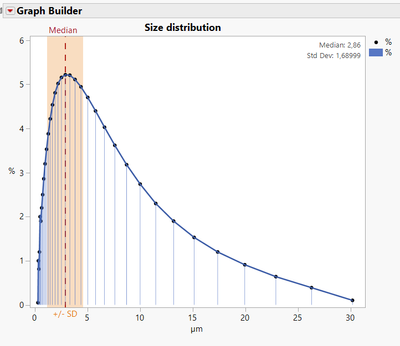

i want to create size distribution curve of this data with% column on x axis. and then i would like to see SD and median as vertical line in the graph. can anyone help plz?

Would this graph be what you're looking for ? :
If yes, here is the script to generate it :

And you can find attached the datatable used for this graph.
You can do a lot of things on Graph Builder, by combining different graph types with MAJ+click on the graph type you want to have in addition of the original one. The caption box is very useful to show summary statistics. You can also take advantage of axis customization, by right clicking on the axis you want to customize, and then go into "Axis Settings", to add line, range, specify the X and Y ranges and modify them, specifying the intervals, ...
Please note that your cumulative sum of percentages is not equal to 100%, but to 101,02106%.
