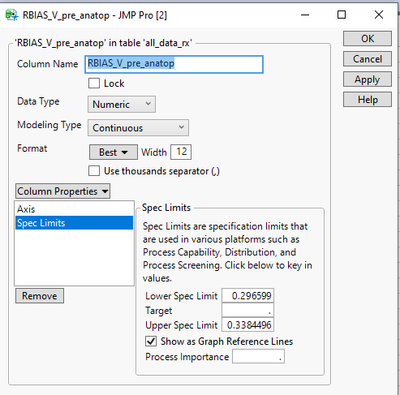

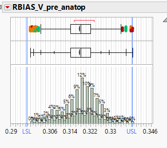

Hi
I have a script that assigns spec limits (USL/LSL) to columns property, and then make a plot of the column, and I expect
to see the limits lines drawn on the plot. What happens is that the limits are set correctly in the table, but not visible on the plot.
If I draw the same plot to this column manually after running the script - no lines again.
If I open the column spec property window, I see the limits, the 'show reference line' is on.
only if I hit 'Apply' and then plot again - I can see the lines on the plot as expected. But I can't get it to work by script..
any idea?
(using JMP PRO 15)

shlomi_bakish
Level II
Re: setting spec limit to column property by JSL - lines not shown on plot
Thanks ! indeed adding the curly braces solved the problem :)
