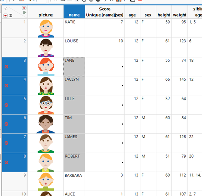

Details you should be aware of:
1) excluded rows are not included in the calculation
[ very useful, along the idea of Formula Editor: meaningful results with excluded rows ,
nevertheless:  somewhat inconsistent, in view of the behavior of other Col... aggregations!]
Names Default to Here(1);
dt << Clear Select << Select Rows( Index( 3, 8 ) ) << Exclude;
dt<< New Formula Column(
	Operation( Category( "Aggregate" ), "Score Unique" ),
	Columns( :name ),
	Group By( :sex )
) << Run Formulas;
1b) unfortunately, the results don't get update when row states are changed:
[TS-00231503]
wait(2);
dt<< Clear Select << Select Rows( Index( 3, 8 ) )  << Exclude;
[to trigger an update, change a cell in the input column and change it back]
2) Just work with "columns", don't work with expressions.
this column has missing entries:
New Column( "Score Unique[1st character of name][sex]",
	Formula( Col Score( Substr( :name, 1, 1 ), :sex ) ))
[This appears to be somewhat inconsistent, in view of the behavior of other Col... aggregations]
[TS- 00215787]

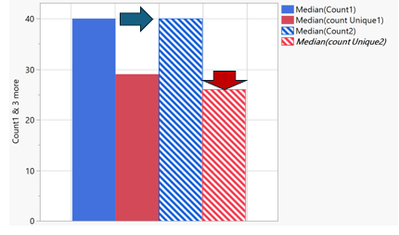

Another level of confusion:
this workaround just works for the new col aggregations - like Col N unique() [red]
For other col aggregations like Col Median(), Col Number() ... it doesn't help to create a new transform column [blue].
They seem to recycle the row state settings which were defined when the first Col aggregation was calculated - or even the results of the first calculation.
gb =Graph Builder(
	Transform Column( "count Unique1", Formula( Col N unique( :weight, :"@Exclude"n ) ) ),
	Transform Column( "Count1", Formula( Col Number( :height, :"@Exclude"n ) ) ),
	Variables( Y( :Count1 ), Y( :count Unique1, Position( 1 ) ) ),
	Elements( Bar( Y( 1 ), Y( 2 ) ) )
//gb =Graph Builder();
dt << Select Rows( Index( 3, 9 ) ) << Exclude << Clear select;
wait(2);
gb << 	Transform Column(
		"Count2",
		Formula( Col Number( :weight, :"@Exclude"n ) )
		"count Unique2",
gb << Add Variable( {:Count2, Role( "Y" ),Position(1)} );
gb << Add Variable( {:count Unique 2, Role( "Y" ),Position(1)} );
the other 2 workarounds are OK:
@hogi wrote:
- change one of the many inputs which trigger an update of the scoped column formula:
   change data filter, overlay, wrap, X axis ... and change back
- save the code and run it again.
