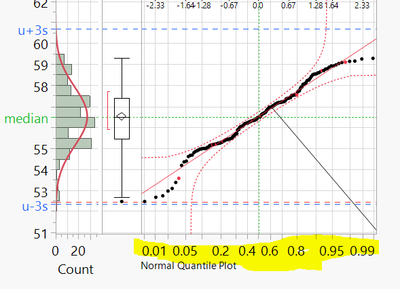

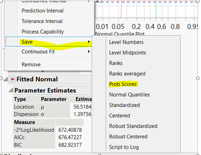

Hi all,
From the distributions I can plot a normal quantile plot and by clicking on the red arrow I can then save in a new column in my data table the probability scores. How do I do that in a script in JSL? I
Thanks, Valeria

Hi,
Here is a simple JSL script that will save the Prob Scores of column XXX in the Current Data Table.
Names Default to Here (1);
dt = Current Data Table ();
obj = dt << Distribution(column (:XXX));
obj << Save( Prob Scores );

Thank you Thierry, it does exactly what I wanted!
