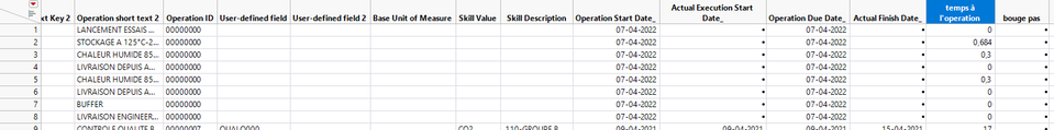

NetflixCrow956
Level III
Re: row operations
For example for lines 2, 3 4... the result is 6 days when it should be 1 day
NetflixCrow956
Level III
Re: row operations
For Each Row(dt,
	If(Is Missing(:"Actual Finish Date_"n),
		:"bouge pas"n = :"Operation Due Date_"n - :Operation Start Date_[Row() - 1],
		"bouge pas"n = :"Actual Finish Date_"n - :Actual Execution Start Date_
It still doesn't work because from the first line I have empty lines in the column :Actual Finish Date_  and I don't know how to do it
