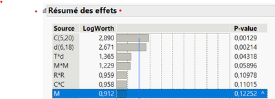

Hello,
After running a custom design, the symbol " ^ " appears next to the P-value of some 2nd order variables.
What does it mean? Does it mean that the variable alone has less influence on the answer than the 2nd order factor ?
Thanks

It means that the main effect is contained in one of the higher order effects (your quadratic) above it, so you should not remove it.
