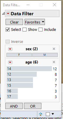

I try to use the "conditional" and "order by count" in the same data fitler.
It can work by manual select, but do not work in the JSL.
The "sort by count" don't work when "conditional" in the same data filter. (please refer following JSL code)
Could any big boss can help? thanks.
Thanks.

I do believe you have uncovered a bug.  Here is what I have found, using JMP 16.1, Windows 10:
If one creates the filter, without any elements selected (Where () ), the Order element creates an ordered list

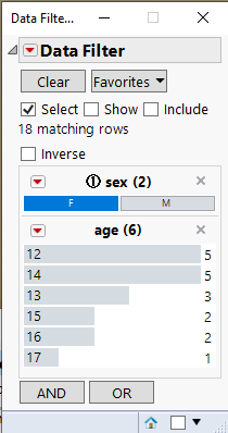

And, if a selection is made to the Sex variable, the Conditional results are ordered
However, if one unselects the Sex choice, the ordering is no longer honored
I suggest that you pass this on to the Support folks at JMP
