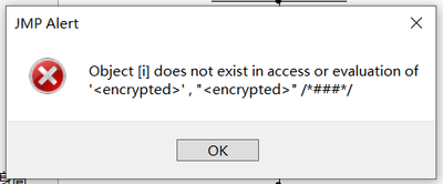

However, an unexpected issue arose. While there were no problems running the script normally, when I encrypted and ran it, an exception was reported upon closing the graph, which has left me quite perplexed.

I have replicated your On Close error with an encrypted script.  I believe it is a JMP bug and I suggest that you submit the issue to JMP Support.

This could really be a JSL Bug, as Jarmo doesn't seem to be able to explain the cause of this error either. I will accept your suggestion to submit it to JMP Support.
