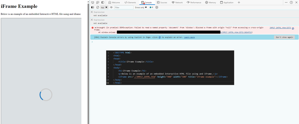

    <iframe src="./bivariate.html" height="900" width="500" title="iframe example"></iframe>
</body>
</html>
In this case, bivariate.html is an Interactive HTML file exported from JMP.

Re: posting interactive html plots on websites
Thanks, Adam.
I tested the page in Chrome and Firefox and it loaded despite the error in the console. In Edge, as you found, and now I also can replicate, the iFrame does not load.  I'm going to ask internally for some help. Please stay tuned.
Hi Adam!
This thread is originally from 2018 and since it was originally posted, some things have changed in the internet ecosystem. The reason this embedding scenario is failing is due to a change in browser's security policies. In 2020, Chrome, and other browsers, changed the default value of one of their policies called a "Referrer-Policy" to something more secure.  This is in order to help protect your data. The new default policy is called strict-origin-when-cross-origin. Note, the default policy is used when no other policy is specified by the server hosting the content. This means, that when two webpages try to communicate with each other, they need to have the same origin. In this case the origin means the same protocol, hostname, and port
The issue you're seeing is a consequence of this browser policy change. In JMP 17, our interactive HTML reports are pinging the parent page to see if extra information is available. Since this policy is in place, we hit an error because we're not allowed to access that parent anymore with the new default policy. We have addressed this situation with JMP 18. That would be the easiest path to get something working.
In your case, it looks like you might be accessing these HTML pages through the filesystem:
window.onload (file://isshfs.xxxxx.com/......./Tool_Counters/Counters.htm:1572:1014711)
It's a bit difficult to fully diagnose without looking at the full URLs, but some browsers treat the file:// protocol paths differently than pages hosted on a webserver and consider them all to be "cross-origin" from one another. One way to ensure these files are on the same origin is to host them from a web server. You'd want the parent page to be on something like https://<your_server_hostname>.com/iframe_example.html  and the child page to be hosted from https://<your_server_hostname>.com/Counters.html.
Sometimes we test with a local web server is using a VS Code plugin called Live Server. It allows us to quickly spin up a webserver using contents from a folder in our filesystem. However, for any kind of production usage you would probably need to reach out to your IT department to spin up a web server to host these pages.
Again, hosting a webserver would be a workaround for embedding Interactive HTML reports from JMP 17. In JMP 18 we've added a fix to avoid running into that error, and you should be able to embed these pages from the filesystem again.
