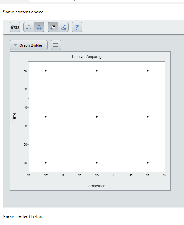

I found a really easy solution!  You can embed an html page within another html page using <iframe> tags.  Here's a really simple example:
<!DOCTYPE html>
<html>
    <head>
        <title>Main Page</title>
        <meta http-equiv="X-UA-Compatible" content="IE=edge,chrome=1">
        <meta name="viewport" content="initial-scale=1.0">
        <style>
            iframe {
                width: 100%;
                height: 600px;
        </style>
    </head>
    <body>
        <p>Some content above.</p>
        <iframe src="Graph%20Builder.htm"></iframe>
        <p>Some content below.</p>
    </body>
</html>
In the opening iframe tag, you link to the JMP interactive html file.  You will need to upload that file to foursquare so it can find it and make sure the path is correct.  You will also want to add styling to the iframe to resize it as needed.  In the <style> tags, I made the iframe as wide as possible and 600 pixels tall.
<!DOCTYPE html>
<html>
    <head>
        <style>
            iframe {
                width: 100%;
                height: 600px;
        </style>
    </head>
    <body>
    </body>
</html>
-- Cameron Willden
