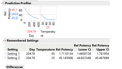

I think what would really help would be gaining access to the data table to look at. My first thought would be to save the differences between the doses using the profiler - I have an example where I'm look at the response change with a process where Temperature is altered, I can activate the profiler option in the Non-Linear, set my temperature (or dose) values and 'Remember Settings', this will save the Potency value with the two temperature settings.
You can right click > Make combined data table and then look at stacking the Rel Potency (or your Y) values together, then performing some sort of group comparison like a T-test using Fit Y by X.
