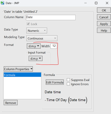

In addition to the response already given, it is possible to remove the time of day; in your case 12:00:00; from a date using JSL:
:Date - Time Of Day( :Date )
All that remains to do is the changing of the column format:

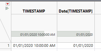

And in more general remove the date of time from the timestamp. If we assume you have correctly formatted data in column called TIMESTAMP, you can use quick formula from right click menu
And it will give you the formula you would use
:TIMESTAMP - Time Of Day(:TIMESTAMP)
You can verify that values have changed by changing the format to Best
