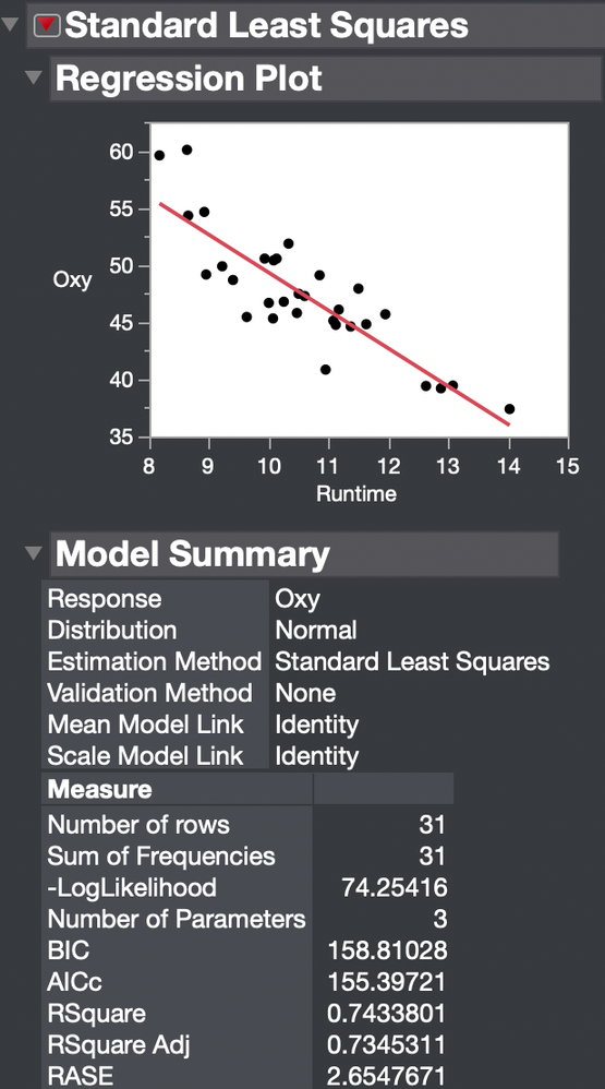

You may have not seen exceptions but they can happen. You are correct that the log-likelihood is always negative because the likelihood is always 0 to 1. Similarly, the -2L is always positive. AICc, though, can be negative or positive.
For example,
Screen Shot 2019-12-23 at 11.00.22 AM.pngScreen Shot 2019-12-23 at 11.00.22 AM.png

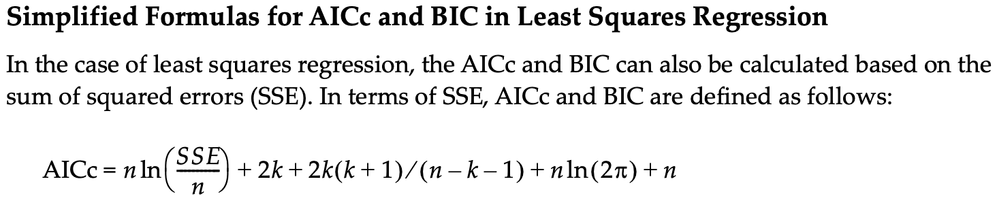

Here is the computation of AICc for a continuous response:
Screen Shot 2019-12-27 at 7.55.36 AM.pngScreen Shot 2019-12-27 at 7.55.36 AM.png
The first term is -2L. So if you have a small SSE (a good fit), then -2L can be negative.
